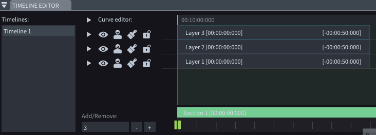

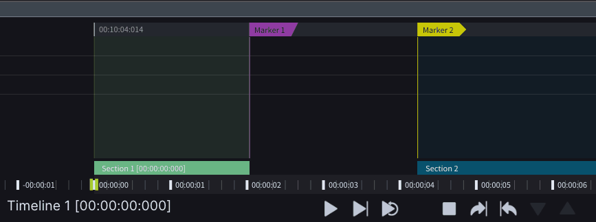

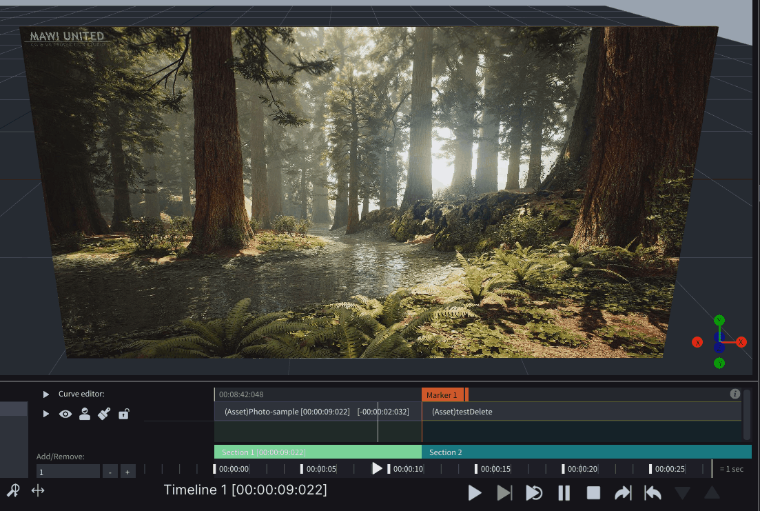

Now you can name tracks in the Timeline editor.
Improved menu for adjusting video length with three options.

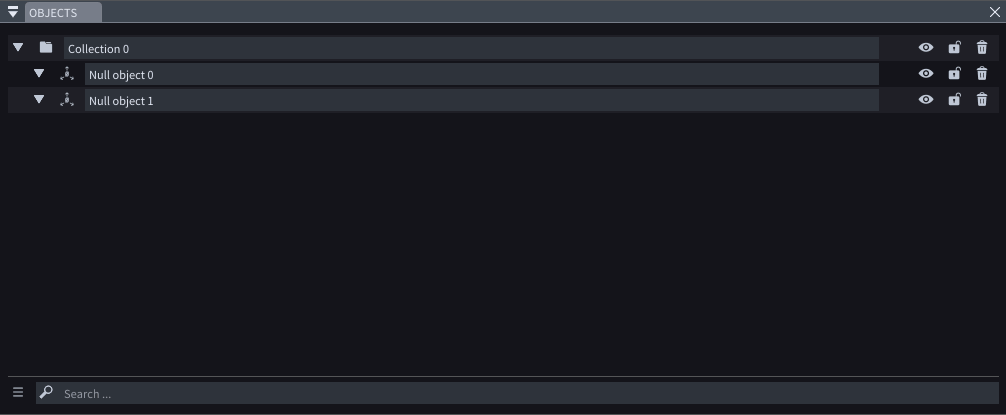

New Duplicate command for objects.

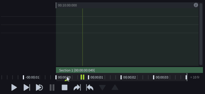

The timeline auto-focuses on the playhead every time it jumps.

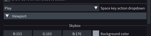

Decide how the playhead behaves when you press Space – play, play section then pause or loop.

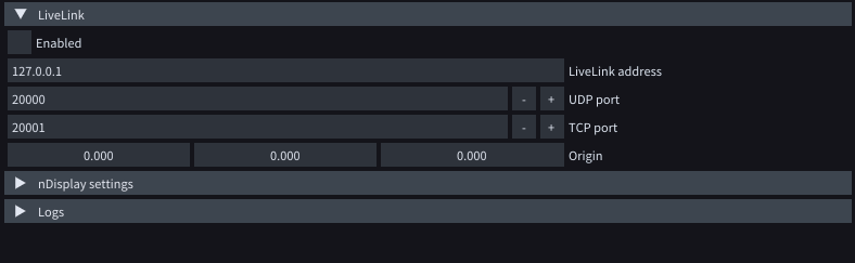

LiveLink objects now show their ID numbers.

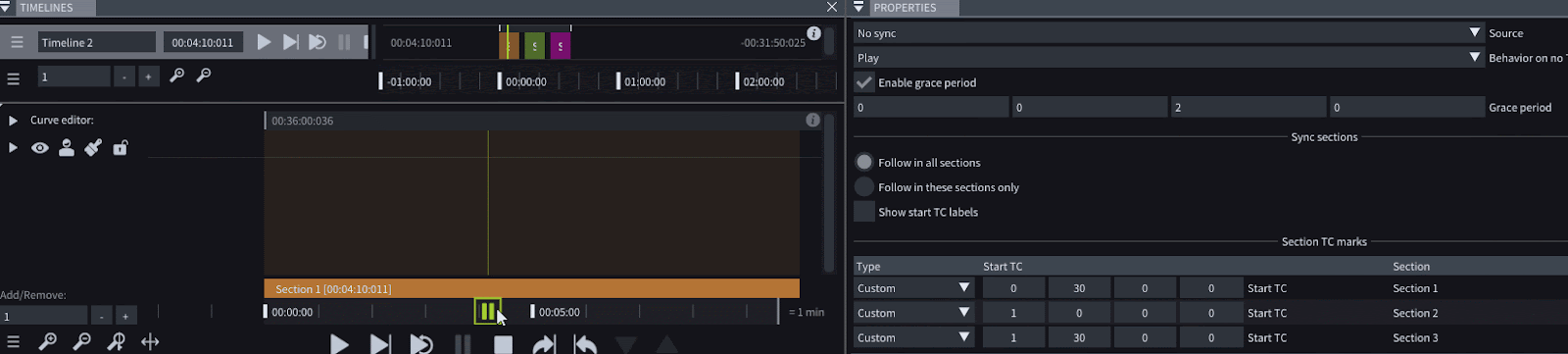

When the Show Start TC label checkbox is enabled, if you click and drag the Playhead on top of a Section with a Custom TC, on the left-hand side of the Playhead icon, you will see its Custom TC time.
Unselect viewport objects by pressing the ESC button.

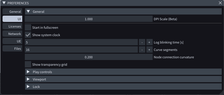

GUI Scaling (Beta) is available with the -earlyaccess launch argument.

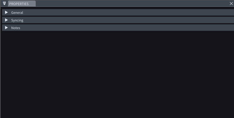

INTERPOLATION
- The Interpolate TC framerate checkbox has been removed from the Syncing section of the Timeline properties. From now on, interpolation between the incoming timecode and the Timeline framerate is applied automatically by default.

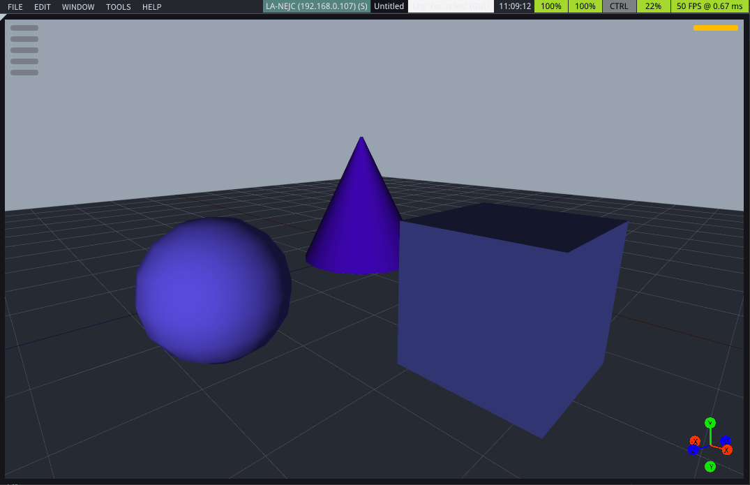

VIEWPORT
- Primitive properties are now propagated in LightNet.
TIMELINES

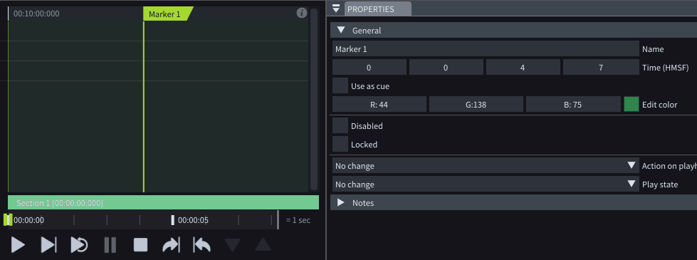

- For easier management, you can either apply an Action on playhead pass or Play state for a Marker. You cannot apply both at the same time for a certain marker anymore.

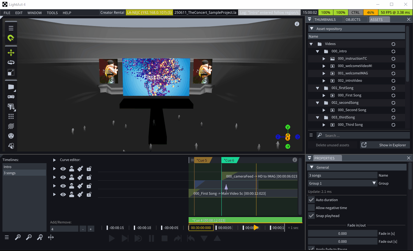

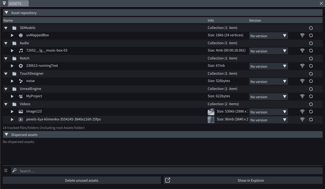

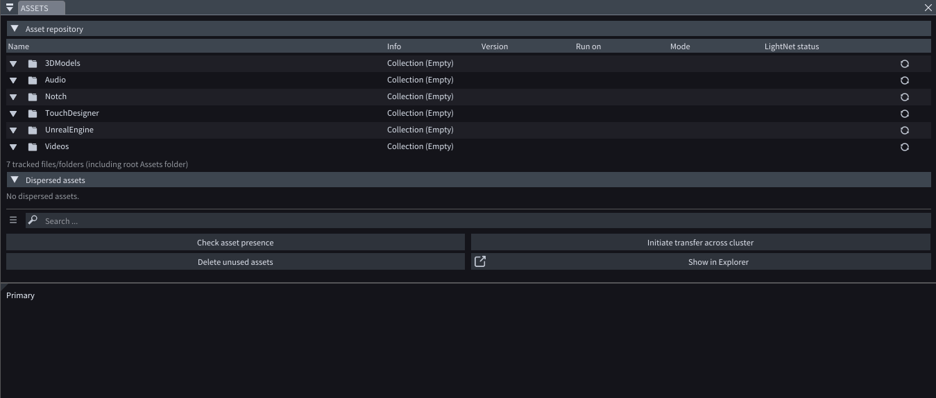

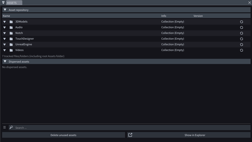

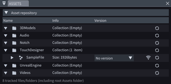

ASSET REPOSITORY
Assets are now categorized as Repository, which auto-update from local or remote sources, and Dispersed, which are manually added to the project.
The asset repository now refreshes automatically whenever new assets are added to the Assets folder.

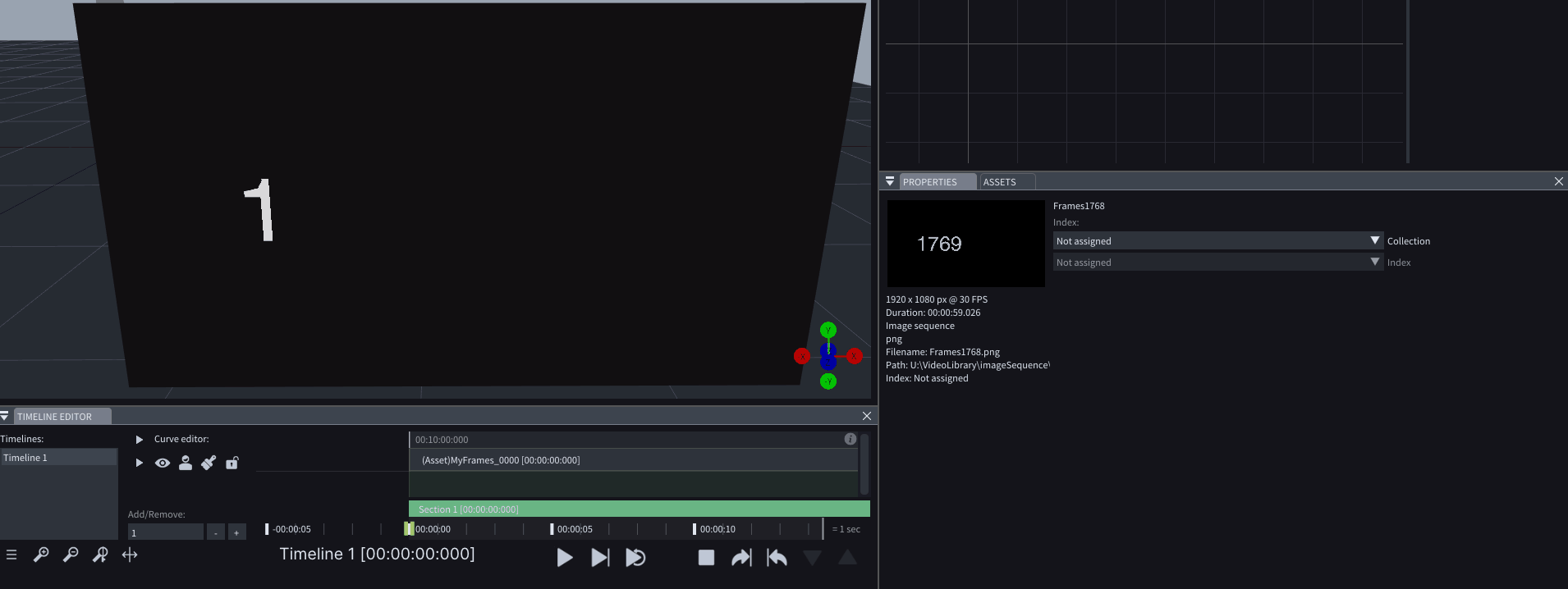

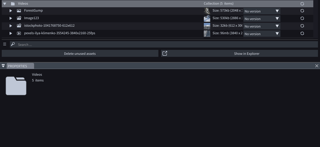

Information about assets is now also displayed in the Properties window.
ASSETS
We’ve enabled playback of PNG image sequences.

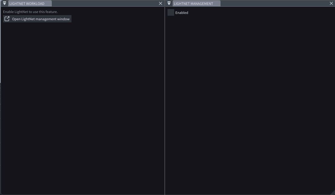

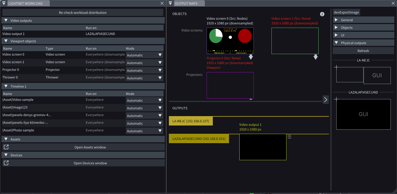

Refined Run on behavior and tooltips in Assets and LightNet Workload window. Workload distribution is no longer in beta.
Asset management actions are now limited to Primary machine only.

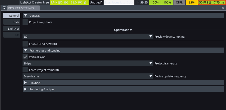

- If Force Project framerate is enabled, LightAct will try to follow the project framerate, but only works without enabled outputs and if VSync is larger than project FPS.

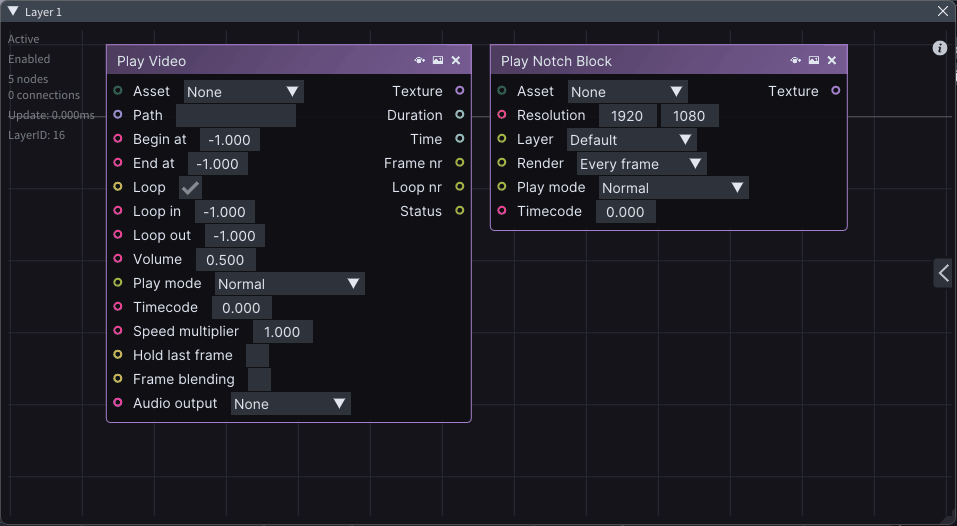

VIDEO PLAYBACK

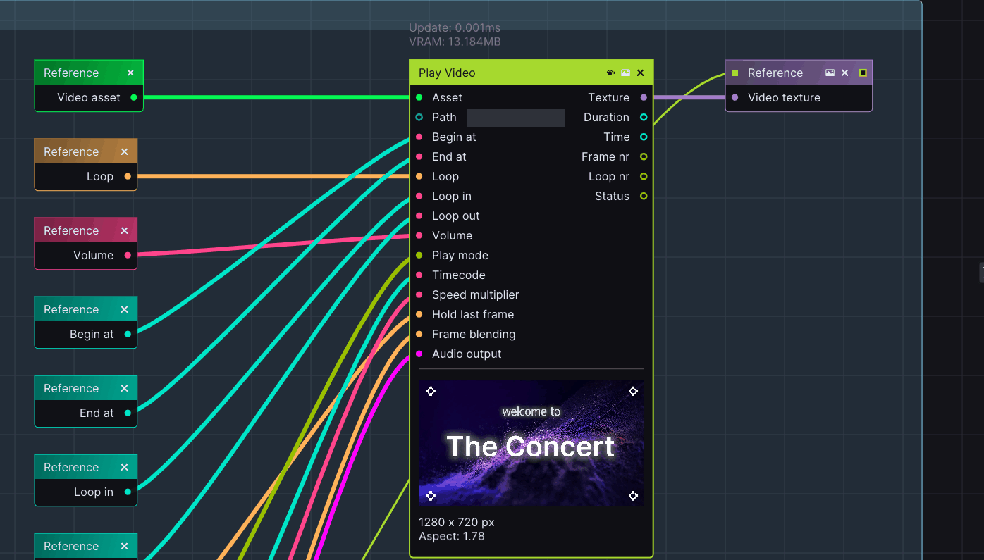

Play Video or Image Sequence node has been renamed to Play Video node. Regardless of the new name, the node’s functionality stays the same.

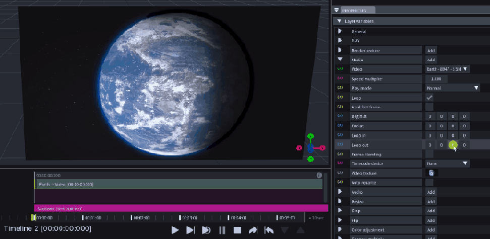

Play Video node now includes Loop In and Loop Out pins. With Loop enabled, playback runs from start to Loop Out, then loops between Loop In and Loop Out; if they’re equal, it loops the entire video.

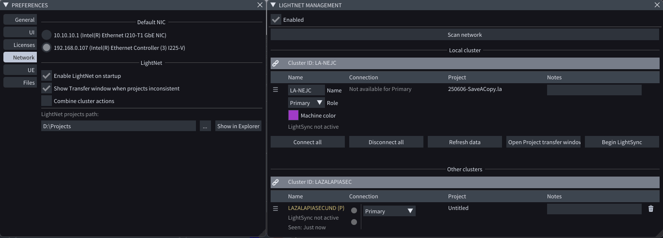

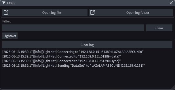

LIGHTNET
We’ve combined cluster actions allowing for a faster workflow.

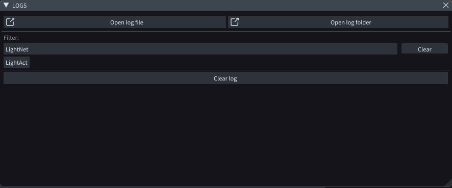

If you have Remote support enabled, there are now additional Logs when Projects are out of sync.
Logs window now shows machine names next to IPs in LightNet.
The Workload distribution is now completely automatic.

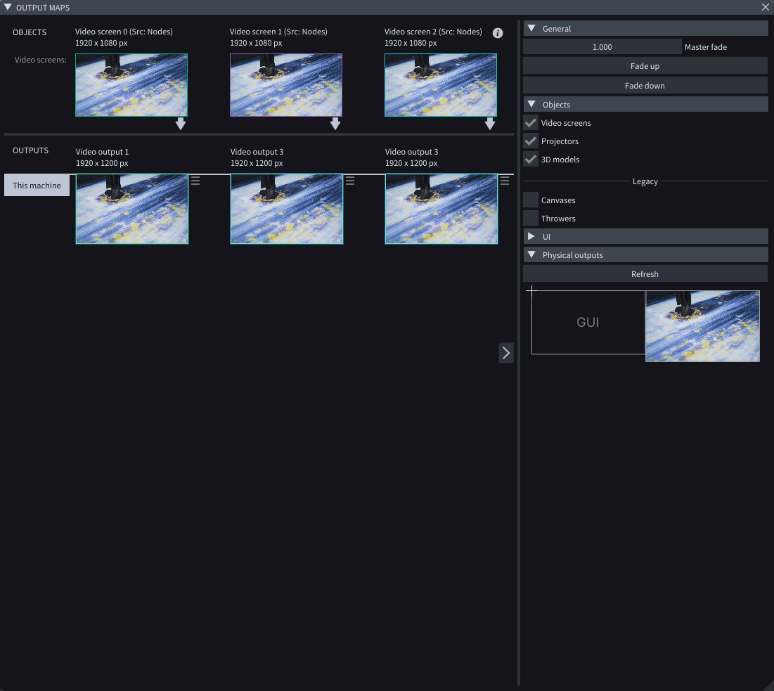

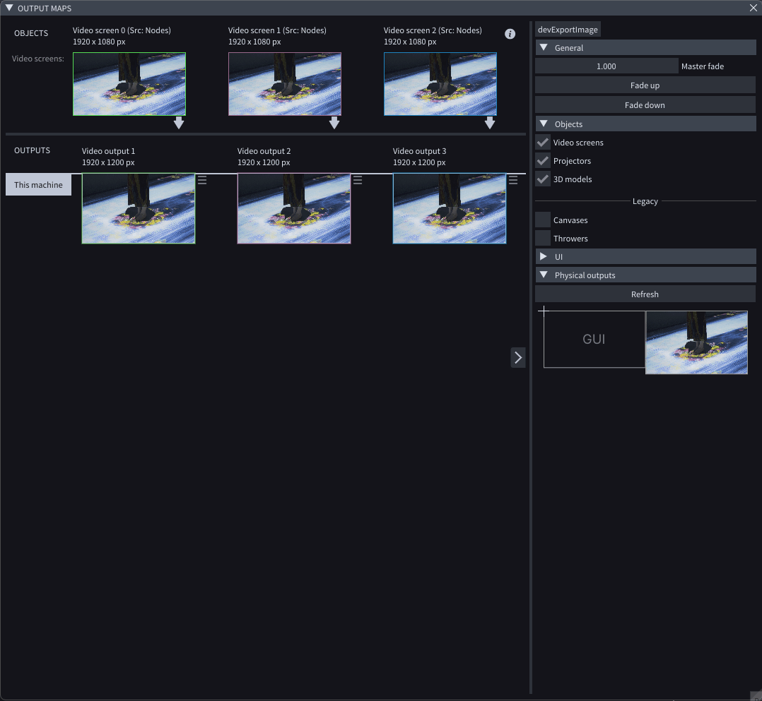

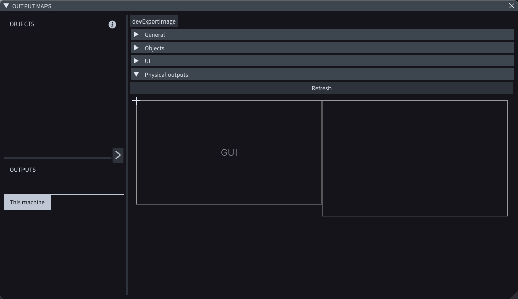

OUTPUT MAPS

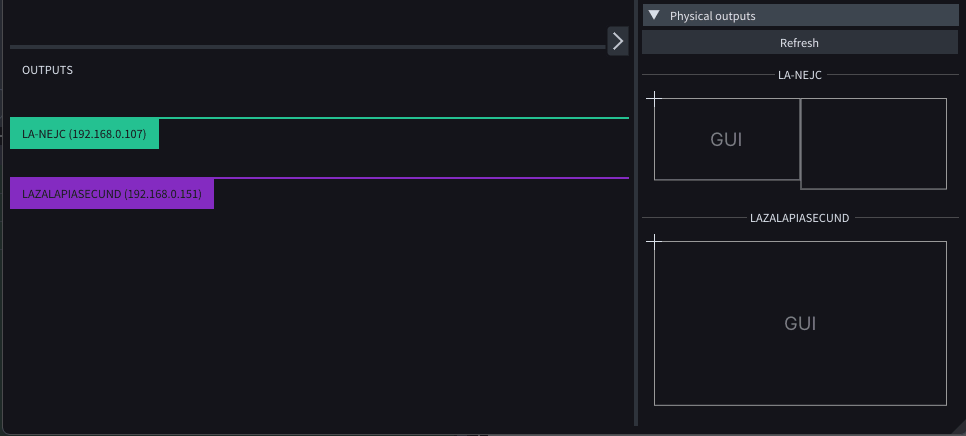

- The Physical Outputs UI now includes a Refresh button, labels the current GUI output and shows a tooltip how to handle multiple outputs.

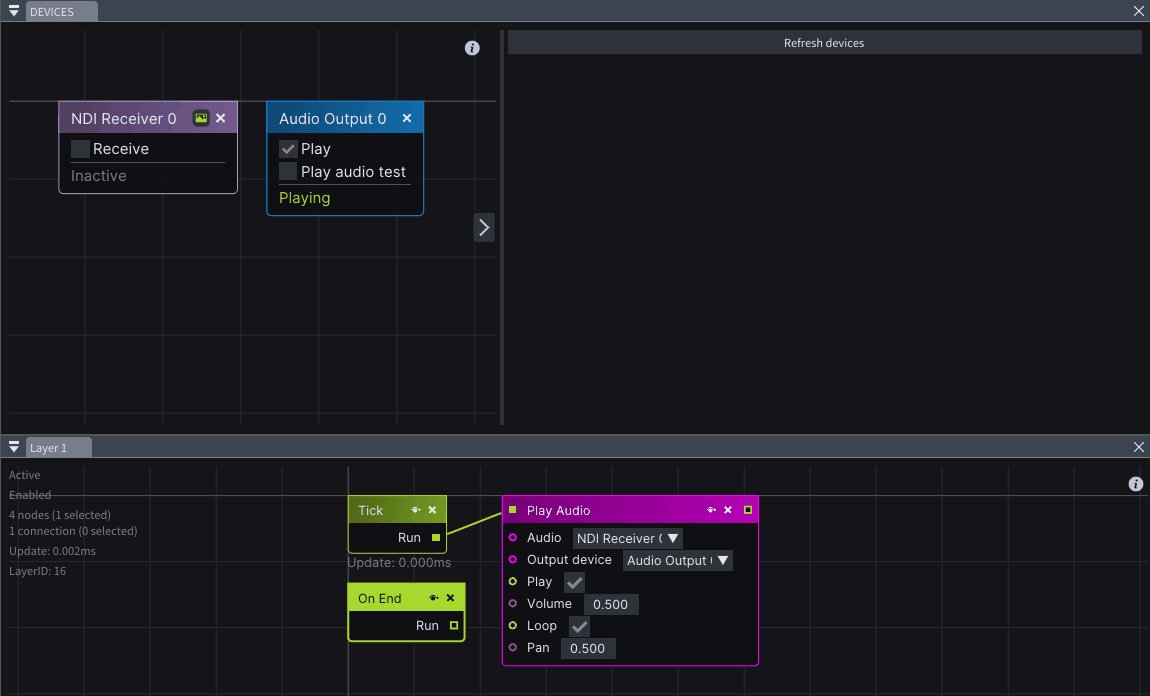

NDI
- We’ve added a functionality to receive audio through NDI.

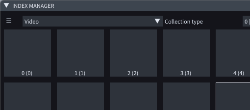

INDEXING
- Updated indexing autofill menu gives you more control.

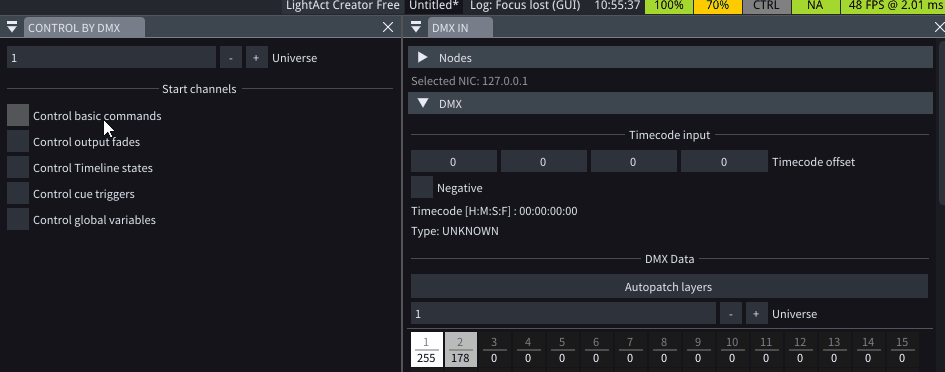

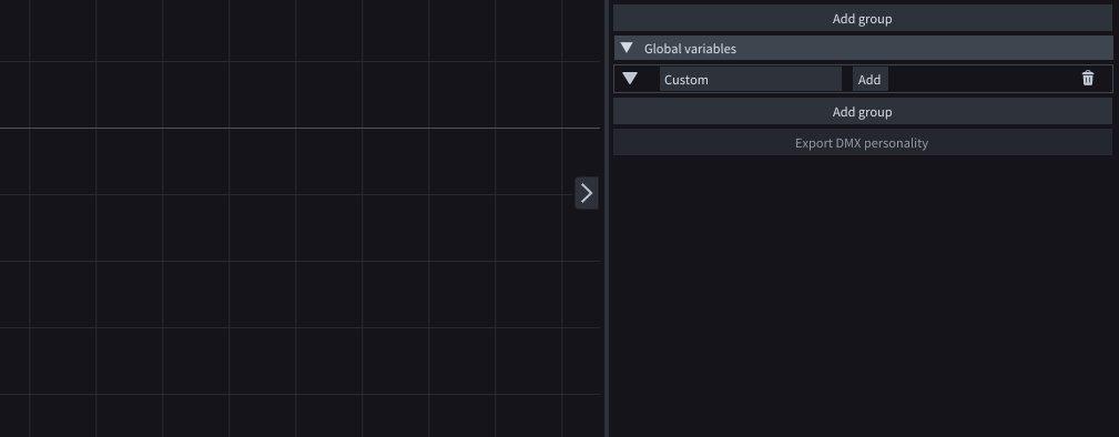

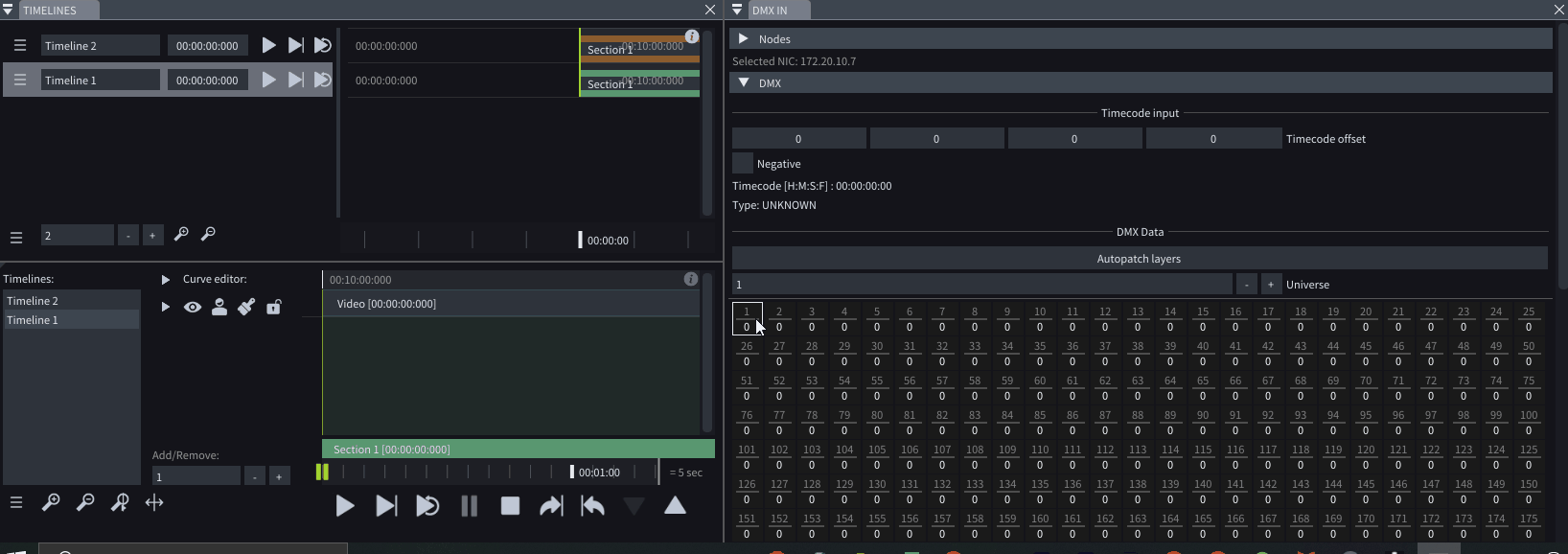

DMX
You can now visualize all patched channels of all Layers across all Timelines in the DMX In window at the same time.
When the Control basic commands checkbox is enabled in the Control by DMX window, you can now control not only the Master Fade but also the Master Volume.

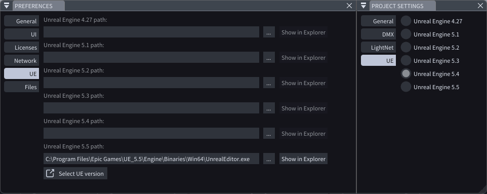

UNREAL ENGINE
- LightAct’s Unreal Engine plugin now supports Unreal Engine 5.5. To get the plugin, please contact us directly at support@lightact.com.

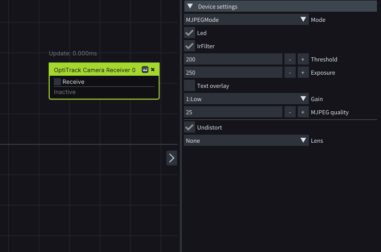

- We’ve added new Optitrack camera un-distort profiles:
- Prime x13 camera: 5,5mm, 8mm
- Slim x13 camera: 4,5mm

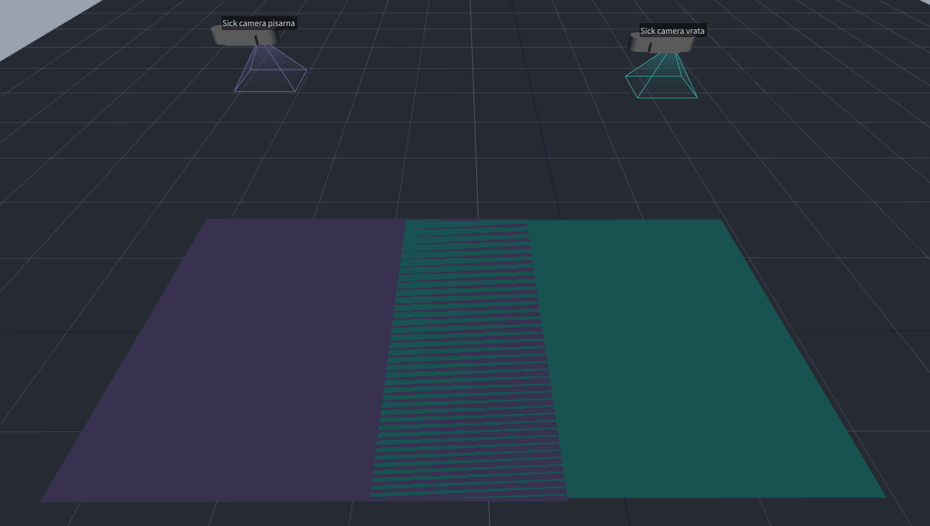

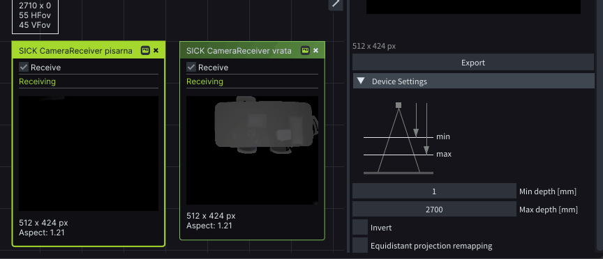

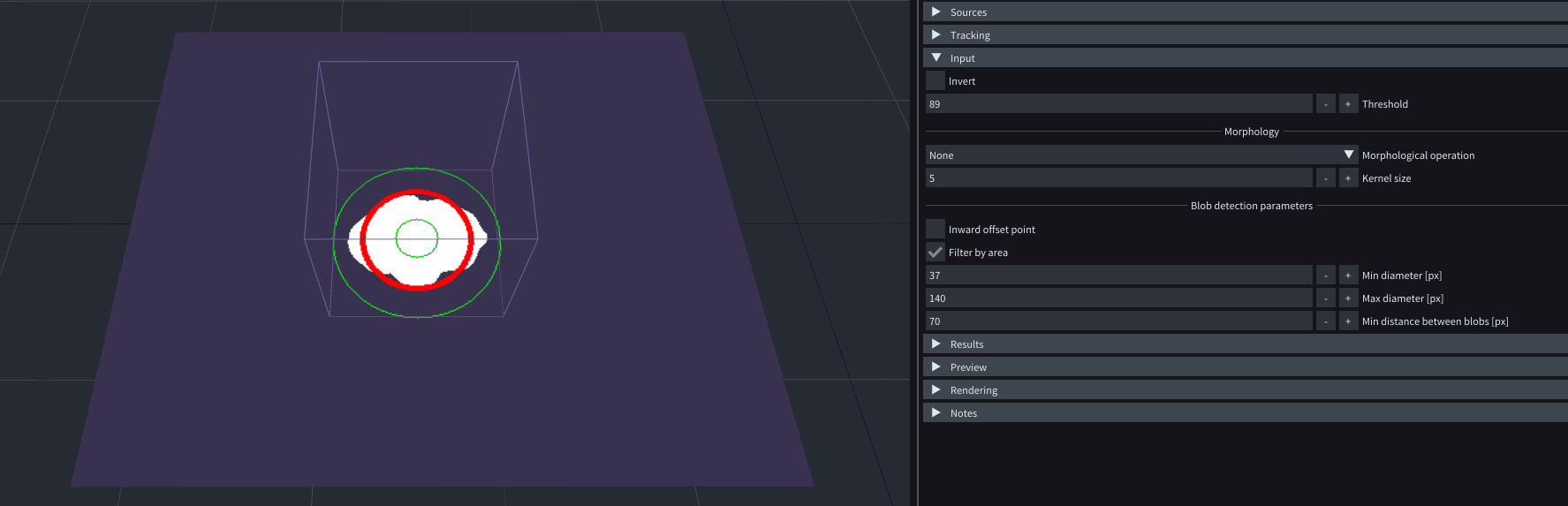

LIGHT TRACK
Improved merging of blobs in overlapping camera zones.
Enabling equidistant projection remapping measures distance along the vertical axis (floor to ceiling), instead from the camera’s point of view.
Compensate for tracked object’s height by shifting the hit point from the radius.

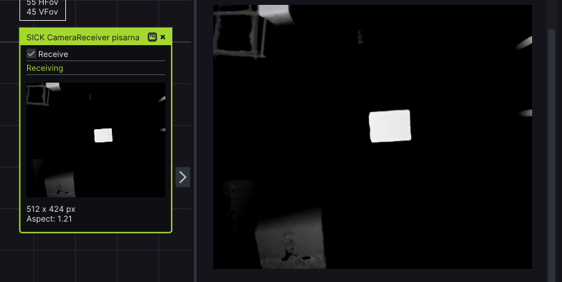

Ctrl + Left Click now shows pixel brightness in SICK camera previews.

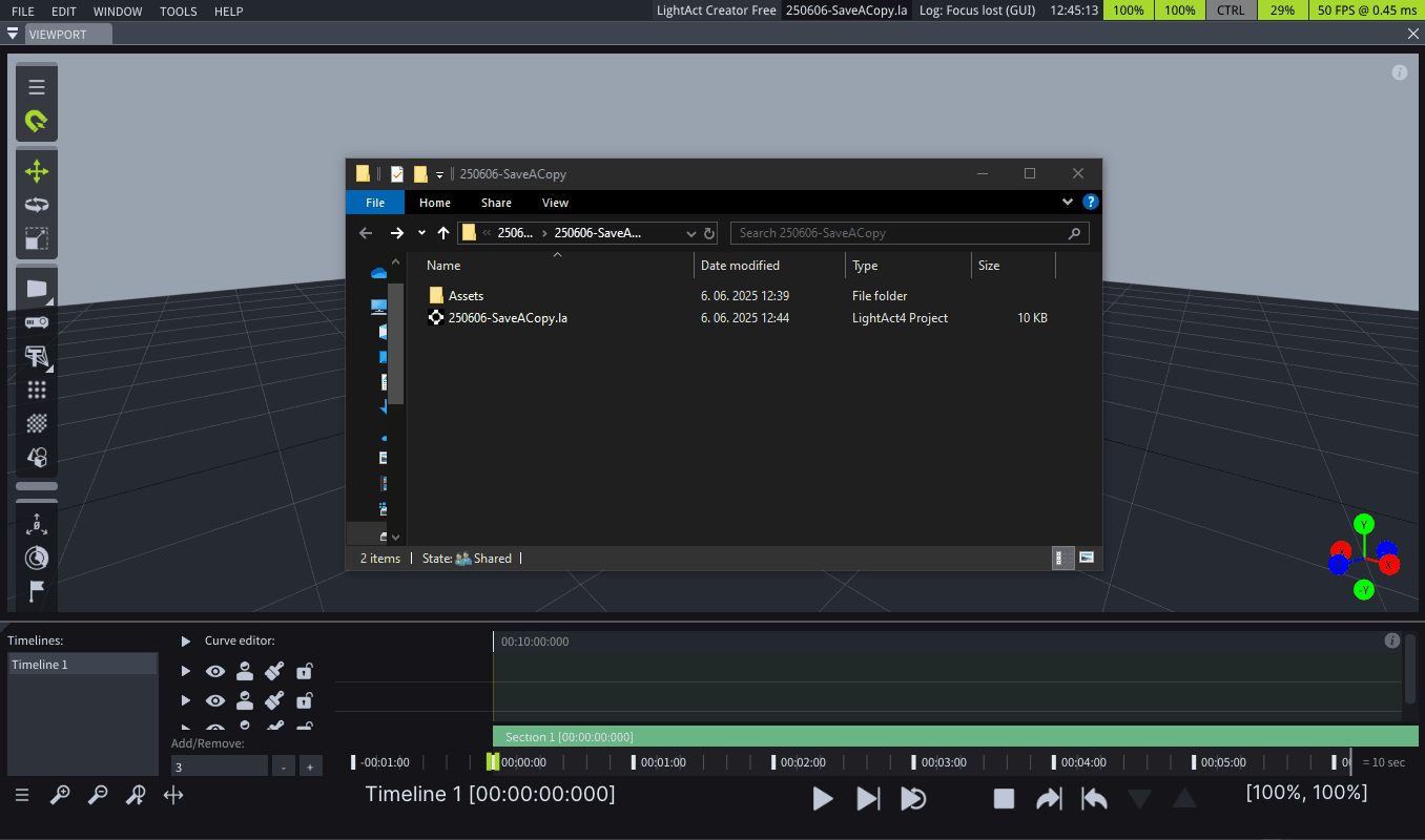

New Save a Copy option replaces old Save As. This option is better for keeping multiple versions of the same project.

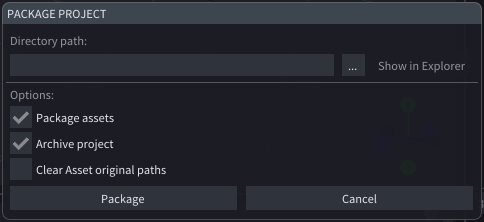

With Clear Asset original paths option enabled, asset filepaths are removed to ensure packaged projects always use files from the .zip.
Play Video and Play Notch block nodes now have Freerun & restart Play mode.

Playhead now pauses on the first frame of the next layer when landing on a marker placed between two layers.
Press M key + Enter to add a marker at the current playhead position.
