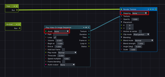

We certainly need to look into this on our end. We plan to do this next week. On the other hand, if you have the will, would it be possible to use a simple video layer instead of the stock Video layer template?
You would basically create a blank layer (by double clicking on the timeline) and then in it create these nodes:
In these dropdowns you would select the video asset and the Mapping (screen for example) where you’d want to render the video too.
Then if you can let me know if the performance is better it would be much appreciated.

Hi @Mitja,
Thank you for jumping in — and for the suggestion!
I just tested the setup you described using a simple video layer with manual nodes instead of the stock Video layer template, and I’m happy to report a big improvement: the playback now runs at around 50 fps, which is a nice step up from what I was getting before. That’s a promising result, and it definitely opens up new possibilities for optimizing future projects.
Thanks again for your support — I really appreciate the quick and helpful guidance!
