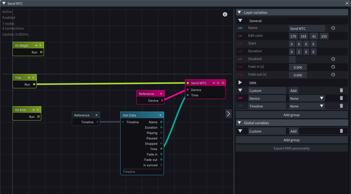

I have created a quick “Send MTC” layer template for you, which you can add to C:\ProgramData\Lightact\LightAct4\templates\user.
Unfortunately, Answehub forum will not let me attach this layer template type of file here, so I would be happy to send it over to you via email if you could share it with me.
Otherwise, you can also reconstruct the layer template I created on your own by starting with a Blank layer and using the “Get data from Timeline” and “Send MTC” nodes. Please refer to the screenshot below:
