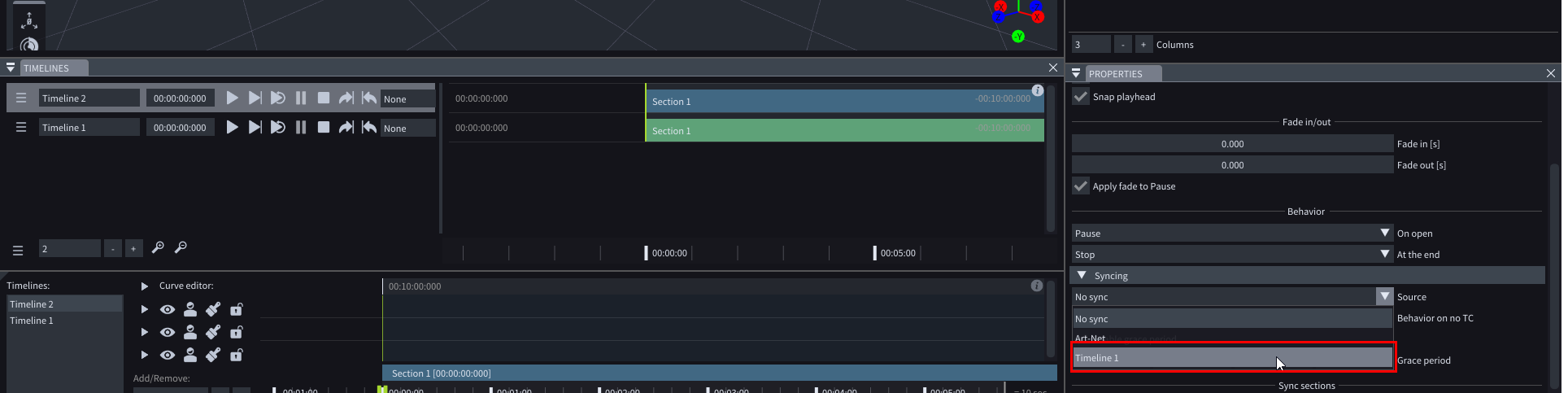

Hello @HMD,
To add to Nejc’s answer, the only right way of syncing one timeline to the other is by using the embedded Syncing mechanism as shown on this screenshot:
I hope this helps,
