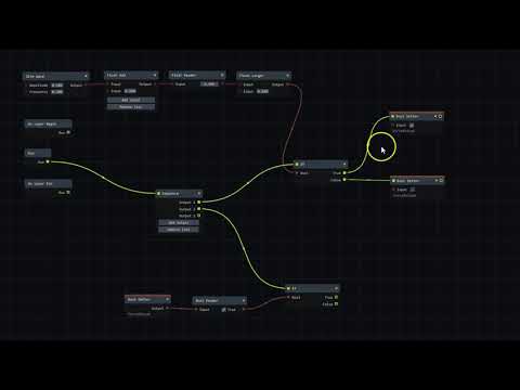

Hello Liam,
I’m afraid I can’t reproduce your issue on my end. Please see the video below showing how it should work:
You can see that forceReload boolean variable switches to True when float is above 0.5 and to False when it is below 0.5.
The chain at the bottom also shows the correct boolean value.
I am also attaching the project that I created when making this video.
booleanTests.la (21.2 KB)
If you still experience this problem please send over the project file so I can have a look at it.
Best of luck!
Mitja
